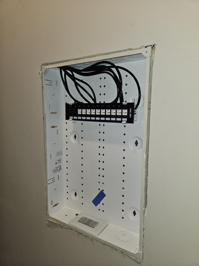

              We are close. Reeeeaaaaallllly close. Electrical is done, HVAC is due this week, and then the blue-tape punchlist.
              Before our drywall and spray foam were done, I'd pulled a bunch of Cat6 cable so that we would have wired internet where we would likely want it. I'd installed a wall mounted recessed patch panel in the water heater closet, and from that, pulled a run to a box on the outside of the house to connect the main feed to the house, one pull to each of the bedrooms, three pulls to my wife's office/craft room, one to the living room plus one to the wall mounted TV in the living room as well as the master. That all sat for the last four months doing nothing.
              Spent a couple hours tonight punching down Cat6 plugs and installing them into the wall outlets. The feed into the house to the central patch panel and four of the outlets to the rooms are finished and tested. Arguably it's the most important four -- the two TV's, the bedrooms for my adult disabled daughter and the guest bedroom. I have one remaining in the master bedroom and three in Vicki's craft room. Intentionally left those for the end, as negotiating power. When I want to wrap up the job, Vicki has a vested interest in letting me finish them.
              Definitely didn't go as planned - both of the cables I started with from my tester and the dongle to the respective outlets tested good, but then I started getting the same error on three different outlets... wire 4 and 8. Swapped out the two cables and everything tested fine. Then as I installed them into the wall plates, two of the rooms started to test bad, due to wires coming loose from handling. Repunched those and they tested good again.

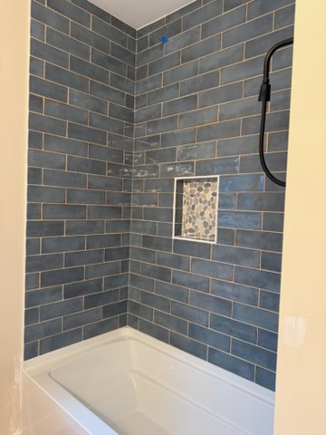

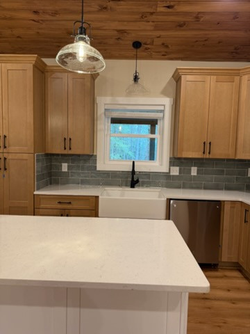

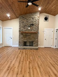

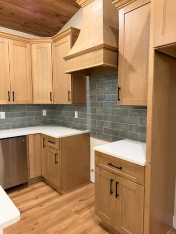

                Cleaners came today....

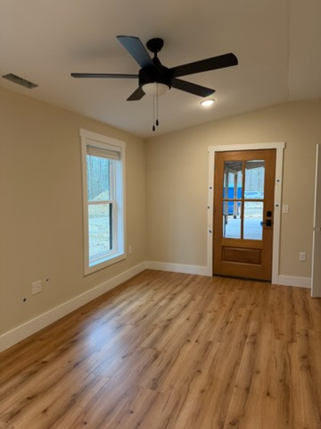

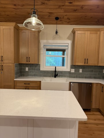

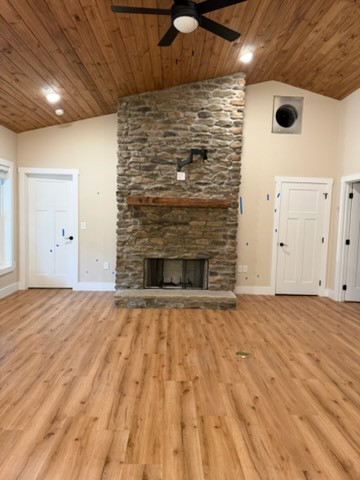

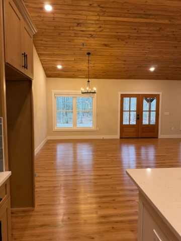

                • #23

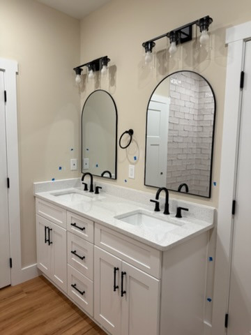

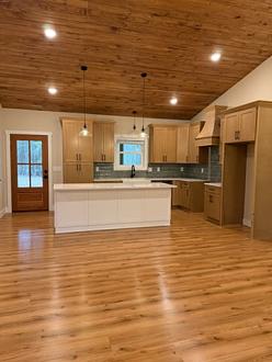

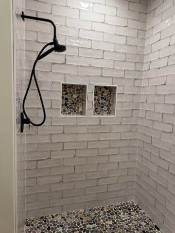

                  and more....
